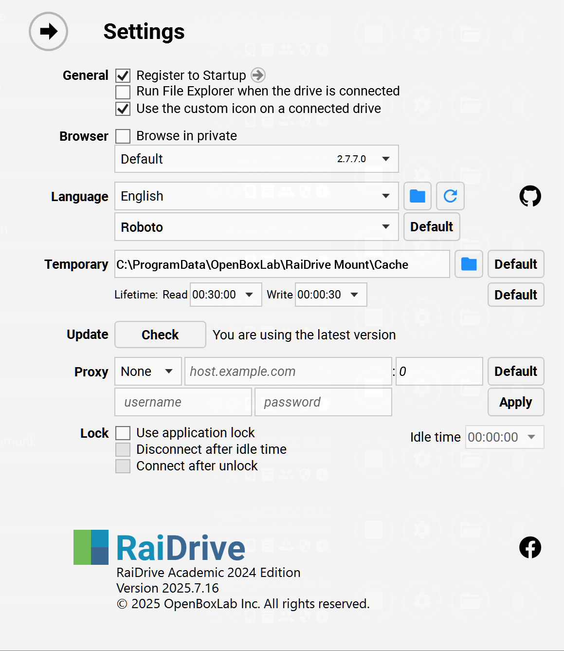

Windows Local Disks Losing Share Attribute After Reboot
10 Remote Drives mounted with Raidrive 2025.7.16 version as public local disks lose Windows share attribute after reboot causing issues with subsequent operations.
Trialed similar program Expandrive prior to Raidrive Trial using the same remote drives and Expandrive does not have this problem so the issue is solvable.
If this issue cant be resolved please inform immediately so I can cancel subscription before RaiDrive trial ends.

Hi, @mj354
The Windows lanmanserver service does not share paths it cannot find.
For example, if you share the X: drive and reboot, if the X: drive doesn’t exist when lanmanserver starts, the sharing won’t start.
This is because the RaiDrive service starts last, and drive mapping occurs afterward.
Even if you connect the X: drive later, lanmanserver won’t recognize it and the sharing won’t occur.
One simple and straightforward solution is to restart the lanmanserver service.
  • After connecting the drive, run CMD with administrator privileges and execute the following commands:
net stop lanmanserver
net start lanmanserver
Be careful, as other users may already be using shared files or printers.
Restarting lanmanserver will immediately share the registered shares and ensure they work properly.
We could restart the lanmanserver service after connecting the drive, but this is a very risky approach.
This is because files or printers may already be in use from a shared location on another drive.
We could also automatically remove and register shares, but we found this difficult to reflect the diverse settings and purposes of users.
We’re still researching and considering this, but stability and other considerations make it difficult to make a decision.
We apologize for not being able to provide a definitive solution. If you have any suggestions, please let us know.

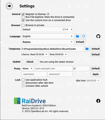

Hi, @mj354
We’ve emailed you a version that adds the ability to restart LanmanServer.
If you’ve tested it, please let us know the results via email or on the forum.
Sorry for the late reply. You initially told me someone would work on it in a week or two so I didnt check back sooner to see your early response.
I have done multiple restarts/shutdown-restarts to see if RaiDrive can now maintain the Local drive connections and it seems to be working using the modified RaiDrive version you sent. There are one or two drives that seem to lag behind the others to get reconnected after shutdown/restart, but if you wait 5-10 seconds before entering your pswd on the login screen to provide time for everything to get situated, all drives will be back up and ready for use.
The options utilized are:
-The drives set to public + local
-Windows share must already be registered.
-Reconnect at boot is enabled.
Thank you for making this modification to RAiDrive.
