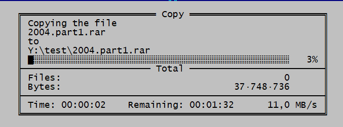

I give you 2 examples:
read - 44 MBytes/sec
Write (till stop) - 11 MBytes/sec
I don’t really think it is slow.
“The request was canceled.” in the log in my first messages because of my drive disconnect in the RaiDrive, it’s not by Yandex.
There is no ability to stop coping process but disconnect. For example (see write.png above),
5 minutes after a took write.png I have this:
It’s good the file access timeout is very long. Unfortunatelly ESC does not help is my case, disconnect helps only.
So, the problem is in network layer somewhere.
Before RaiDrive I used another WebDav client (I like RaiDrive much more ) without any single problem.
RaiDrive has no problem in it. The problem is in Yandex cloud itself.
