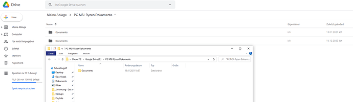

RaiDrive creates new folders without overwriting the existing ones in my google drive mount. Happened 3x times now (last on 16.12.2020).

Happened yesterday again! Now i have proof that raidrive doesnt correctly report: RaiDrive reports one folder (the newly created yesterday), but there are two on my drive online. The oldest is from the 16.12.2020. Might there be a date issue? There is exactly one month between the folders?

So, after some time the issue appeared again (but i didn’t notice right away, so don’t know if the duplicates showed after some time; they are there now, but a level above, hinting part of the path wasnt showing, which led into the recreation of the needed folders).
Thats why there are 2 folders with a following “(1)” i think.

The issue with (1) in the name is due to the nature of Google.
Google allows multiple files or folders to have the same name.
But Windows doesn’t accept the same name.
Therefore, RaiDrive is supposed to automatically add a number like (1) in this case.
This can happen if there are actually two files or folders with the same name in Google, or a temporary synchronization failure.
If the drive is disconnected and then reconnected, if (1) is added, it is actually the case that there are two identical names in Google.
A lot of effort is being made to minimize the case of temporary synchronization failure. Please try the latest version.
