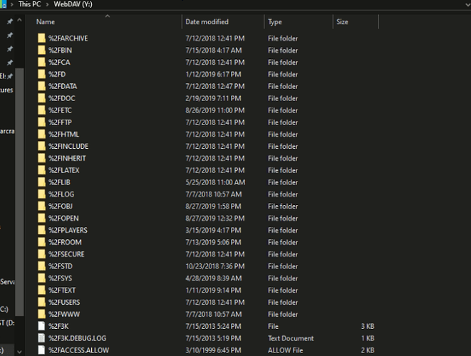

The webDAV server I am connecting through uses a PHP script to handle WD connections. The endpoint is /webdav.php/ - this mounts fine, except all the files and folders mount with “%2F” at the beginning of their names.
The files don’t open, and the folders are all empty because obviously the names aren’t correct. Every other program I have mounts them correctly (odrive, mountain duck, expandrive)

The WebDAV is this server running on nginx.
Thanks for your reply and a nice clue.
We’ve research the source code of server and then found out the reason why %2F is displayed.
It will be fixed in the next version.
