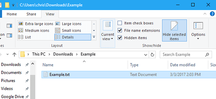

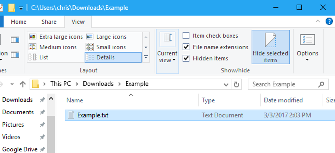

If you do not see the ProgramData folder in the C:\ drive, please refer to the link below.
