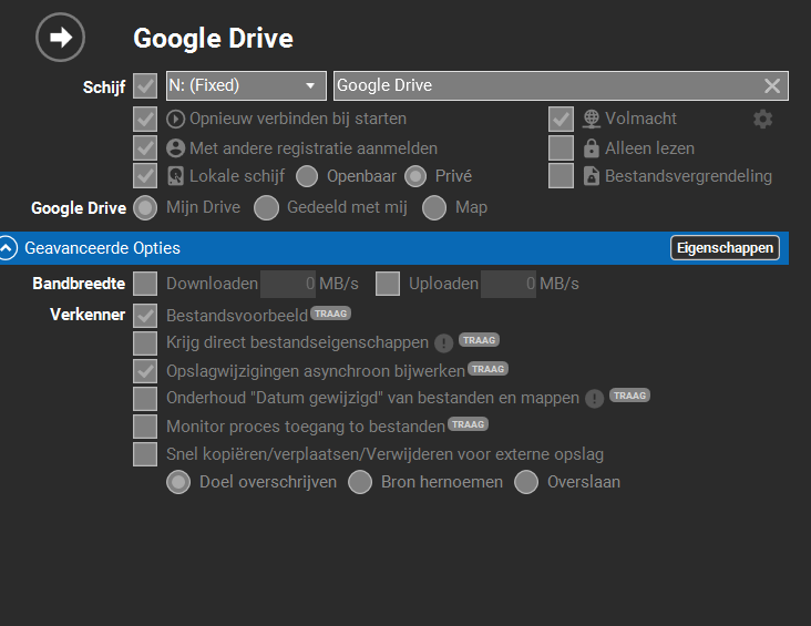

im having issues with addin my google drive. this was working before but suddenly not anymore. not sure what to check or uncheck. does anyone know how to fix this? im using the latest raidrive version.

It has been confirmed that the issue occurs when there are files in Google Drive with very long filenames (including extensions) exceeding 260 characters.
If you have such files, please move them to another folder and test again.
Please let us know if the issue is indeed related to filename length.
