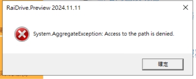

I installed raidrive on terminal server. When someone opens raidrive, “system.aggregateexcetion: Access to the path is denied” will pop up when the second user clicks. Is there any way to solve this?

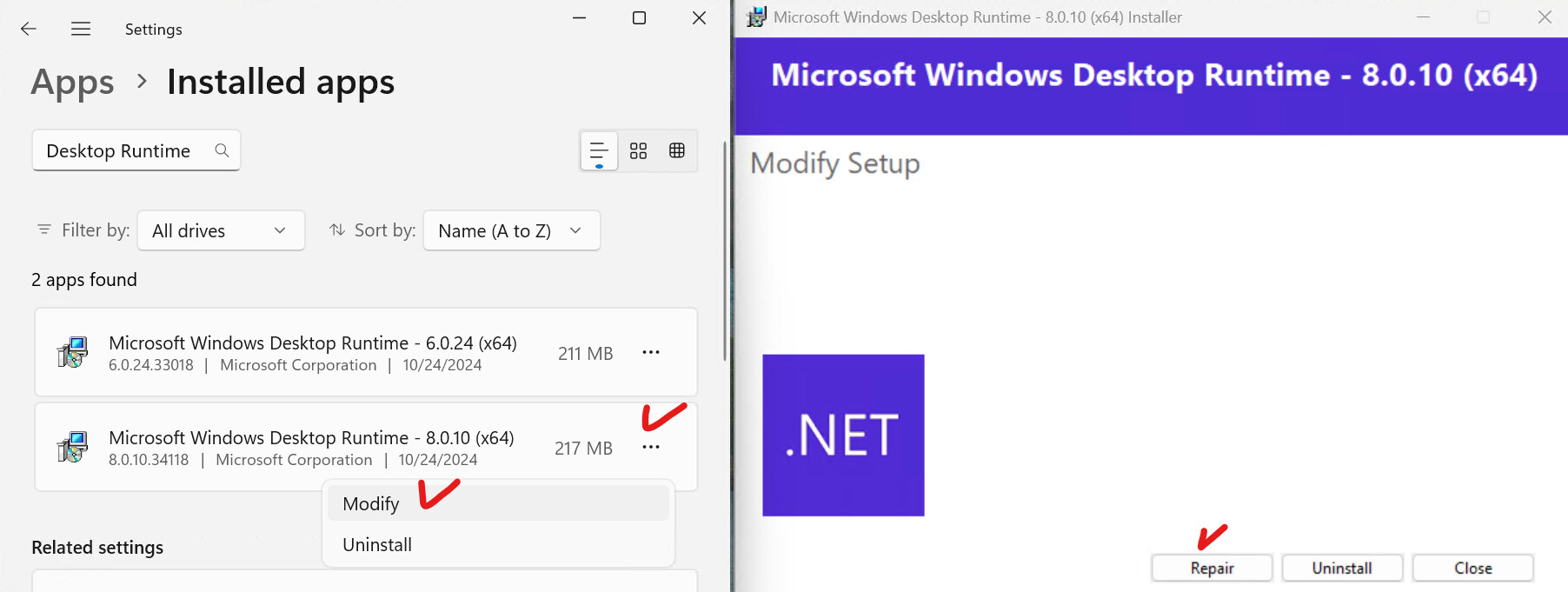

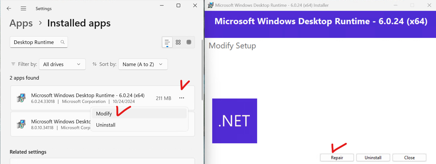

It seems to be related to .NET.
Would you like to try to repair it as shown in the screen below?
For 2023.x.x version:
For 2024.x.x version (PREVIEW):

Sure, RaiDrive needs .NET.
So I need to install this software separately?
I have installed it, but when I open it, I still get this error message.
He will only get this message when the second user logs in, not the first one.

Because I found that as long as someone logs in and turns on raidrive first, other people will have this problem if they turn it on later.

I am wondering if it is possible that a certain program is executed by the first user when the first person logs in, causing the second person to be unable to open that program and report an error.
